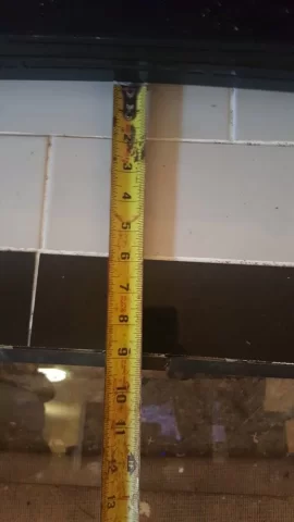

So I'm going over the manual and it call for 16" clearance from the floor, my hearth is 17" but the stove sticks out so I only have like 9" from the front of the stove to the end of the hearth. My inspection is a month away so I'm thinking if I tile a 1 foot section of the floor where it meets the hearth would that be ok. Open for ideas

Yes, maybe continue it with some black tile or dark slate at the floor level.
Would that do the trick
What is under the tile of the raised hearth, that the stove is sitting on? They require Type 2 protection. "FLOOR PROTECTION: Use UL 1618 Type 2, R = 0.45"
I have no idea, bought the house with the existing Fireplace, all I can say is its 18" off the floor

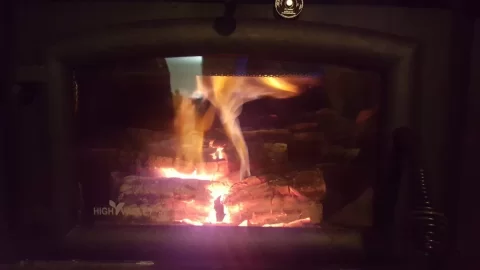

Started it at 4pm today
Reactions: Woody Stover

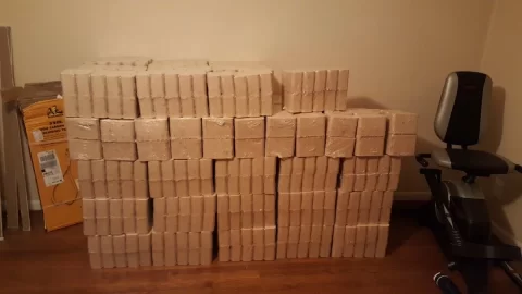

I did end up picking me up a ton of liberty bricks[Hearth.com] High Valley 1500 Catalytic stove insert installation and review

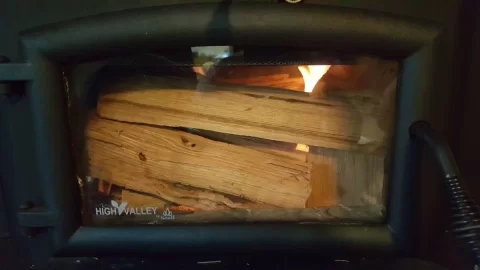

5 and a half hours .This thing is impressive air closed almost fully but she purrs lIke a kitty lol
