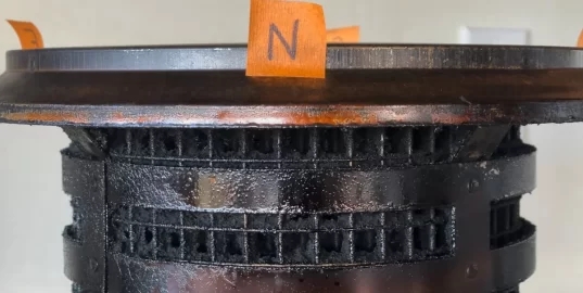

I added a blower to my stove a month ago to pull more heat from it, and afterwards noticed doing so does rob from the cat temps. I've been careful to keep it in the active range so as not to damage the cat, but it became a battle as my chimney cap was slowly choking itself. I certainly made the issue worse the last 10 or so burns where I ended up smoking out my house. I didn't realize the exhaust issue and was trying to activate the cat hoping that additional burn would add the heat needed to get the stove operating properly. This was pushing smoke from what may be high moisture pine through the cat repeatedly as the fire always smoldered out. Do you know how likely this may have damaged the cat?

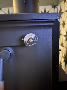

I don't have a flue gas probe, all I have is the cat thermometer that came with the stove. If you feel I should get one do I drill through the double walled pipe to install it?

Built-in Temp Probe :
I think the temp probe on the side of these catalytic Hearthstones can be misleading. If the stove is hot but settled into the coaling stage of the burn, the probe will read "active" despite there not actually being any combustion taking place in the cat. If the blower is cooling the dial face of the probe, it will read lower temps than if not, which may create discrepancies/confusion. Just because the probe is in the "active" range somewhere doesn't mean that we can throw a heap of fresh wood gases at it and expect it to be immediately combusting efficiently. A fresh load of wood will produce relatively cool gases. For me, a full load of wood from a cool start (stove body under 125F), will usually drive that temp probe to about 80-90% of the way to the "too hot" transition line. Subsequent fuel loads in a warm stove on hot coals will usually flirt with and ride right on the "active/too hot" transition on the probe for several hours of the burn cycle. I suspect that the bigger firebox plays a role here, but I would still expect a load of properly seasoned fast burning pine to spike temps closer to the max on that probe, especially with brand new cats, which are known to be a bit more "active."

Double wall requires a "probe" style thermometer, and yes, that means drilling the stove pipe, Install in accordance with the thermometer install instruction. Most call for 18" above the surface of the stove.

Your cats are probably fine but if your chimney/cap is that plugged up there's a chance your cats are also plugged up. I would inspect them and make sure they are clear, not packed with soot. If they are plugged up use an ash vac (for indoor use) or a shop vac or compressed air (outside!) to clean them out. If they are like mine, they can be lifted out pretty easily for cleaning, check the stove manual for specific instructions on that. At minimum the cats and the various surfaces above the baffle in the stove should be vacuumed every time the chimney is swept.
