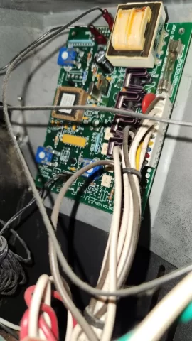

Nothing.Nothing happens on test mode ? Do you have a volt meter/multimeter to check for voltage going to the auger motor, carefully...
Yes. A fuse, and a MOV.The fuse is beside the white molex connector. Either a 5 or 6A fuse. Most likely blown. If fuse is blown, replace it and unhook igniter if fuse holds the igniter is bad. If it still blows with igniter unhooked, plug igniter back in and unhook combustion blower and retry. Those are the 2 things that typically blow the fuse on the circuit board on a Harman
I'll have to get into it tonight and take a picture.The fuse is beside the white molex connector. Either a 5 or 6A fuse. Most likely blown. If fuse is blown, replace it and unhook igniter if fuse holds the igniter is bad. If it still blows with igniter unhooked, plug igniter back in and unhook combustion blower and retry. Those are the 2 things that typically blow the fuse on the circuit board on a Harman
Cool. Ill pick up a 6A fuse over the weekend and give it a go. Thanks!Never had do do an Advance, but I would imagine there are screws to remove, and panel slides out? If not, the board will "pop" off those nylon retainers. You could call Don at East Coast Hearth, he will know.
Just from the pics, looks to me like fuse is blown, and the wire terminal insulation for the igniter look like they have been very hot, possible bad connections there.
