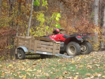

Here's my repurposed jet ski trailer, Found it on the bay of all places for local pickup only $50. Tires were dryrotted -nothing slime can't fix. Picked up a cull piece of PT plywood for the deck and some 2x4, 1x4, reused all the carriage bolts off the old loading rails and some I scrounged off a an equipment pallet. It's only 2 inches wider than the quad which is exactly what i needed for getting into the woods around my place. I cut the tongue so it tracks better on tight trails. The only other thing I may pick up is a couple pulloff atv tires/wheels the narrow tires tend get mired in some of the wet draws and i have to winch myself out.
I know this isn't in the class of woodhaulers posted above but its got a 700lb rating way more than quad is rated for.
