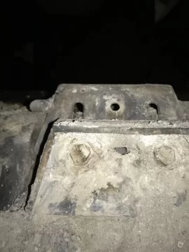

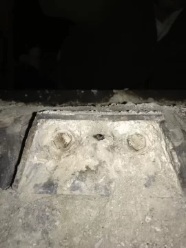

This shows the plate. I lifted mine up so you can see.
Some other things to think about the bricks on a new stove have moisture in them, also after several fires the clay and bricks of the chimney warm up and it should be easier to get a draft. My feeling the more you burn the better it will work.
Yes, I undid the screws and removed the plate. I'll have to wait for a few days to burn with this spring like weather. And yes, each fire does seem to be better

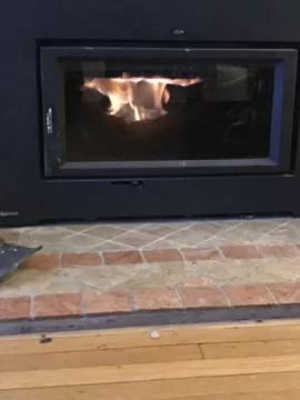

Here’s a picture of a nice slow burn but with this stove if there are no flames as long as the temps are above 500 the cat is doing its job and it will still throw out some serious heat. With no flame the glass will go black but when you give it air and get big flames it will start to burn the black off.
Looks good.
Engaging the cat at 500 is still awkward for me . I'm used to engaging at 1000-1100 as my previous unit had the thermometer 12 inches up on the flue.
So when I see this unit get up to 1000 i got a little nervous. What are average temps users are working with? What should the stove run at. Manual does not really mention this.
Good evening, finally some cold weather and stove is cranking. Removing that piece from the inside to expose the hole definatley helped to get some air into the fire box.

Looks good.
Mine I run up to about 1300. Then turn the air down. It settles at 1100-1200 for a few hours then slowly decreases. I try to reload when I am around 400 or less but there are always enough hot coals to get going quickly.
