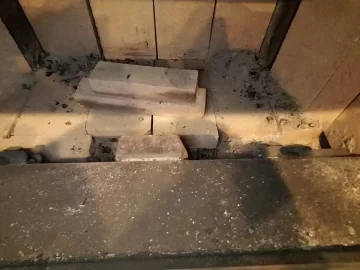

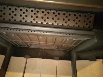

No it’s more obvious it’s above the brick on the metal. If you look inside there’s a hood look under the hood you can see the hole.

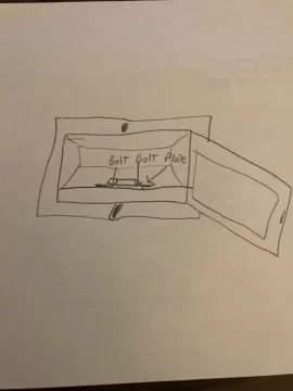

I’m not an artist but I hope this helps.
You don’t need to take the bricks out inside that little medal hood there should be two bolts I think 7/16.
