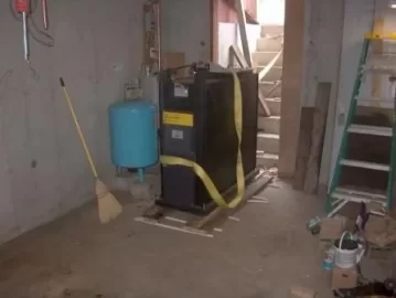

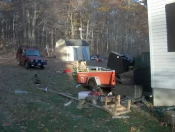

It can be done. I man handled my 1500 lb TARM into the basement all by my self. It just takes a lot of patience. I was concerned about the clearance to the top of the door frame once I started to transition from the steps to the basement floor but it worked out with an inch to spare. Try making a cardboard cut out the size of the length and height and test it out.
I pulled it off the trailer with a come a long and had the winch from the truck to keep it from sliding too far. It took a lot of running back and forth, if you have someone to run the controls it helps.
  • [Hearth.com] Gasification Boiler in basement or Outdoors
