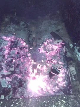

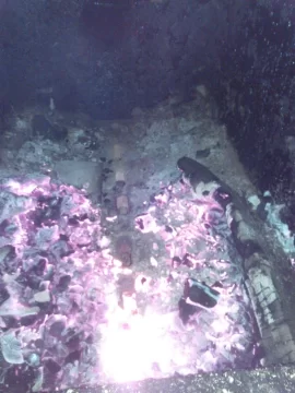

I have a break through I think?
Last night I had a bunch of family and friends over and one of them is an engineer the other my brother inlaw who is very mechanical with lots of experience. Their professional opinion was not enough airflow. This led us to the fan which appears to have been modified at some point in the wg's life. The fan cage itself is pretty bent up and at initial inspection it seems that the motor was replaced and the gasket assy has been poorly modified. Most importantly we are not sure what the spec measurement of the tolerance between the squirrel cage fan and the fire tube in the boiler itself. Their opinion if there is to much distance between the end of the fire tube and the fan itself drastically reducing the cfm's. We removed part of the poorly designed modification and got the fan cage at least 3/4" closer to the fire tube but there is a lot of damage to the motor shaft and the fan itself. I will call AHS tomorrow and price a new fan assy, I also found deterioration of one of the ceramic blocks, I will price those as well.
The next challenge will be how much $ i want to put into this thing!

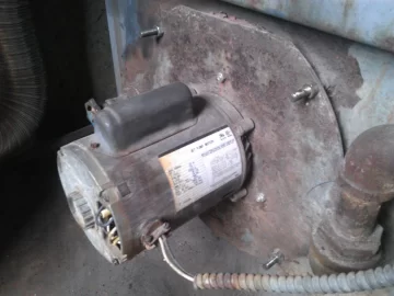

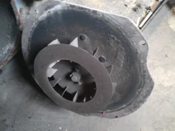

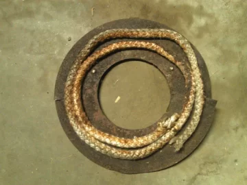

See a few more pictures of the fan. [Hearth.com] Eshland Wood Gun 140. Please Help! New operator with zero gassifer experience [Hearth.com] Eshland Wood Gun 140. Please Help! New operator with zero gassifer experience [Hearth.com] Eshland Wood Gun 140. Please Help! New operator with zero gassifer experience [Hearth.com] Eshland Wood Gun 140. Please Help! New operator with zero gassifer experience

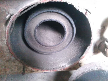

These are [Hearth.com] Eshland Wood Gun 140. Please Help! New operator with zero gassifer experience [Hearth.com] Eshland Wood Gun 140. Please Help! New operator with zero gassifer experience [Hearth.com] Eshland Wood Gun 140. Please Help! New operator with zero gassifer experience extra nozzles I got with the WG. The guy that I bought the Wg from new a guy at a foundry and had a set of cast iron nozzles made up. Thats what im running in it now.
CAST IRON Nozzles? Now that is a crazy idea!
I'm trying to picture what is "different" about your fan assembly at this point. Did you take any pictures of the "modifications"?

It sounds like your previous owner was a bit of a tinkerer...probably not only in the positive way.
The fans are a bit finicky, but that isn't a WG thing...that is a squirrel cage fan thing. That distance sets the air gap and is critical. Have you seen an improvement?
I got that plug from Darren and put it in last week. I never really had much of a "huffing" problem, but I figured I'd give the plug a shot. I have to clean the lower tubes tomorrow so I will know what 1 week's burn with the plug looks like.
I'm not surprised AHS is helping you out, they are a great bunch of guys who are really committed to their boilers. If you don't have any leaks I don't see any reason not to keep her up and running.
ac
Thanks AC.
Moving the fan closer seems to have helped a little but I have not tried putting in a full load of wood yet. I just looked up the motor online and it was org. intended for a shallow well water pump. So ya I would say the last guy had a motor failure and just rigged up a motor that they had laying around. Darren did say that it was the right rpm 3450 and the right hp 1/3 so it should be ok as long as the bearing hold out. Im not that comfortable with this WG to throw 600.00 at it for a new fan assy. This thing will probably go another 10 years w/o a leak.....or maybe not?

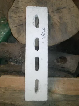

These are View attachment 121750 View attachment 121751 View attachment 121752 extra nozzles I got with the WG. The guy that I bought the Wg from new a guy at a foundry and had a set of cast iron nozzles made up. Thats what im running in it now.
Cast iron nozzles?? The picture of the one by itself looks like refractory.
How long have the cast iron ones lasted so far?
I went my first full winter, than another winter and then a whole summer heating DHW with my set of nozzles.
I changed them out before this winter started and I went through about 18 cord. I probably could have made it through this winter but I didn't want to risk damaging the shelf they sit on. An ounce of prevention is better than a pound of cure.;)

infinitymike The nozzles that are in the wg now are the cast iron ones, the previous owner had a friend @ a foundry cast them. Im not sure how long they have been in there but I suspect its been a few years? If you look @ the last pics I posted of the FB you can see the cast iron nozzles in the picture. The nozzles that I took a picture of are a brand new set that the previous owner gave me with the purchase. You are right mike this wg is a whole new animal makes my last boiler look like a model T. Mike I really like your style with the videos that you have posted (please keep posting them). I was so happy when I came across your youtube videos. you are like the only WG on youtube, so I want to thank you for putting them up. I learned more about the WG in your videos than i have in the last month of trying to use mine!
