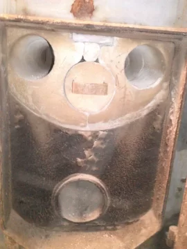

That's an interesting center tube plug set up. Not sure if that's the issue.
I really think the huffing is ONLY coming from too small of a split.
The WG is not fussy at all.
It's a Beast and loves big, heavy, manly splits, not these little wimpy playing card sized splits that the other guys need.

I had my first case of huffing in over a year, last week. The splits were just to small.

Just hang in there. You be just fine. Once you get past the learning curve things will smooth out.
Have you called AHS for any of their advice?
They came out with an EPA plug that is to be put in one of the side tubes and is claimed to help with huffing. I haven't gotten one yet but a couple other guys have and they seem to notice the difference.
