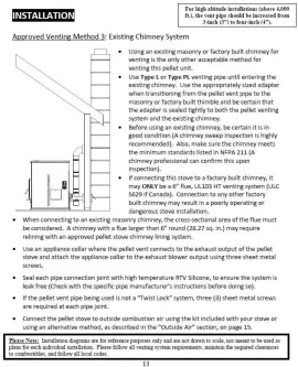

EVL - hey Smokey, or anyone, what is the factor for 5.5" vertical liner? Just my 3 90º bends put me at 15'. I know with the wood stove the taller you go vertical the more draft you get, not less, but I'm not sure if this is true for pellets (cooler exhaust temp?). Not sure if it means much but on a low heat setting 1 or 2 even the factory LBA setting of 4 seems to too much air as the pot will burn down to nothing sometimes. I actually turned the LBA to 3 after my thorough cleaning and gasket job. I'd turn the feed rate up instead, but I don't need more heat at the moment and this thing is already burning more than its rated to.
Yeah the big stores like Lowes are more interested in what makes them the most money it seems, not keeping a full supply of little odds and ends that very few people need. Its practically a department store now. I almost always order online, heck I bought both my pellet stove and 20' chimney liner online and shipped to my door. But this gasket issue had been dragging on and I wanted to get it done then. There happened to be a small county stove shop actually about the same distance (~30 minutes one way) from me, though in the opposite direction of everything else. But was worth the trip they had every size of gasket available as they are full service stove shop. However I was just guessing on the thicknesses. The 5/8" seemed to compress less than 1/2", which didn't seem to be any thicker than what I had from memory, so I went with some really thick stuff. Think it was 7/8 or maybe 1". For the ash pan I decided to try rope gasket instead of the flat stuff that doesn't seem to be very compressible. Went with the smallest they had, think it was 1/4". I didn't get anything for the hopper, will have to do that one later. All their gaskets where white, so it doesn't look as nice with a bunch of white along the edge of the black door.
Burn pot... I did try to put it in vise and it helped a little but this is pretty thick steel that's welded to the vertical side and not very wide so its not like there is going to be much give. I could try placing some of the flat gasket from the ash pan under it, maybe I'll try that next cleaning. I don't think filing is going to do anything since its warped up in the middle, not down. Maybe if I filled in the bow with weld, and ground that flat, but that would take forever and I could probably never get it perfect anyhow.
Chimneys of that dimension are very iffy because your combustion blower really can't push that much air out reliably and when cold the stove will also have issues getting enough air past the igniter to light reliably. Pellet venting and liners generally max out at 4" with an EVL of 30. But you need to understand that many factors enter into a flue working.
For example Harman has a double paddle impeller that can really move a lot of air, there are some combustion blowers that can move a lot of air, your elevation can have a large impact. It isn't as simple as the easy to add up and compare to a table seems to make it.
Back to back exhaust direction changes can get into the way as can not making certain that the venting is always going upward.
EVL is independent of the vent size, the maximum amount of EVL a particular combustion blower can handle is vent size dependent up until the stacks air weight becomes an issue.
I do not have the tables that deal with your 5.5" to tell you how much you can get away with if any. Normally a decrease in vent size as you get closer to the stove is a larger problem than a decrease going in the other direction due simply a lot of weight trying to get down the vent. Vent sizes should be as uniform from beginning to end as possible.
ESW seems to be pretty good in their manual, and followed this one for my setup. Unfortunately it seems to leave a lot of helpful info out though for venting install. On page 13 it describes mine very closely, venting into existing chimney. 3 90ºs in the picture (except the bottom one of mine is a regular 90 not a clean out tee), goes into the chimney a couple feet above the stove. Manual states cross section max of 6" round, mine is lined 5.5". Gives no limit or even mention of height other than minimum vertical rise on another page. Gives no mention of 3" or 4", except that the entire thing could be comprised of 3" up to 15' length run. Not sure if I'm going to keep this stove permanent or not, so might redo later, but for this year I'm hoping this setup works and my problems where the gasket or burn pot.
