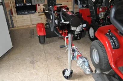

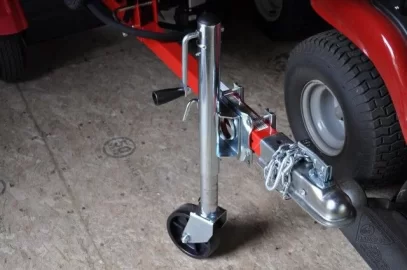

I saw someone with a front wheel on theirs just last week. I have to do that too. I am going to see if I can get something a bit more all terrain though...
Here's a pic of mine, with wheel. First thing I did, since the splitter likes to move when going from horizontal to vertical and it's easier to put on/off the ball of my truck/tractor.

Dennis - I though about a nose wheel for my 27 ton. After a while I noticed an opening under the beam that will accept a 5" diameter, 8' long stick. I loop the saftey chains over the top and it's pretty easy to move the splitter around. The ground I'm going over is soft and bumpy so I would have a hard time with a normal 6" trailer nose wheel set-up.
ATB,
Mike P
Thanks for the tip Mike but I think the tongues are a bit different. I will check though! My old splitter has a longer tongue and a wider axle than the newer ones.
