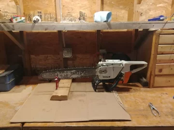

  • Chainsaw question?
Interesting little bit of sharpening. I usually watch these and pick up one little trick. The square file video that they mention had a couple of things I've never done like sticking a wedge on the bottom side of the bar to put extreme tension on the chain.
