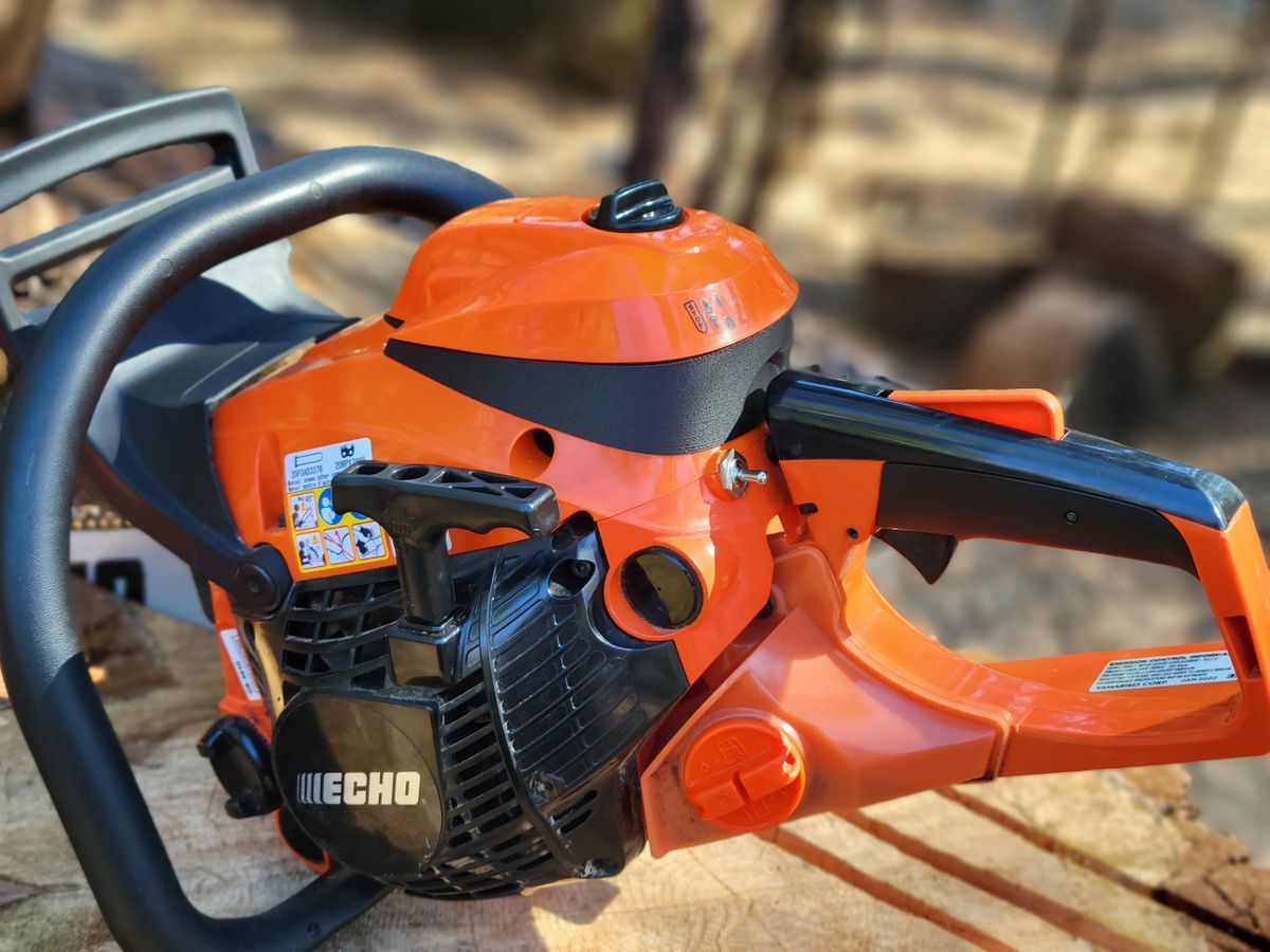

Needs a pre filter. How would a thin piece of open cell foam work. It’s a bad design.Yes, I'm buying one.
I did wash mine with warm water and soap, got stuff out, but the discoloration remained. Sawdust color. So not sure how well it cleaned it (have not run the saw yet).
It's a mesh of some synthetic fiber, it appears. Not woven, but random strands. Not cloth.
If soap and water are the only ways people clean air filters, then I'll do that.
I'm still rather bugged by a saw that needs a new filter after 4 tanks...
It’s what my lawn mower uses. I like them better than paper/cloth as they are easier to clean oils off of. And pretty sure that’s what my ryobi uses. I think the do a good job. If you can keep oil off them they are easy to clean out. And you still have the original to catch smaller stuff. I don’t consider chainsaw dust a really fine particle.Open foam would not filter fines...?
Blowing didn't work well - too dense it appears
Normally you don't see that fine dust, being outside etc.It’s what my lawn mower uses. I like them better than paper/cloth as they are easier to clean oils off of. And pretty sure that’s what my ryobi uses. I think the do a good job. If you can keep oil off them they are easy to clean out. And you still have the original to catch smaller stuff. I don’t consider chainsaw dust a really fine particle.
I'm sorry, as I said above, 1/2-5/8 inch long chips show my chain is not dull.If you are getting flour , your chain is dull. Filters- I clean mine with a heavy duty cleaner degreaser straight up. That de-solves the pitch and such as well.
