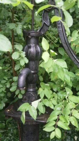

I recently discovered that I have a well 20' from the house. Does this discovery and the 30% tax incentive materially change the business case for geothermal? I dismissed geothermal 6 years ago because of the cost of a system using horizontal trenches in the lawn. Is a 5" cast iron pipe big enough to get a heat exchanger down?
Five inch should be big enough. It would seem to me to depend on the depth of the well, the groundwater, and the load.
I assume I can simply unbolt the hand pump and drop a bob in to determine depth? What is the groundwater variable? Making sure it won't rot the heat exchanger or how big the aquifer is for heat transfer?

The plumb bob should work. The depth of the water over the bottom of the well is important.
Water depth is important because it tells you how much water is in the hole to cover more heat exchanger area. More water is gooder, means you can have more surface area exposed to cold water.
