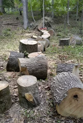

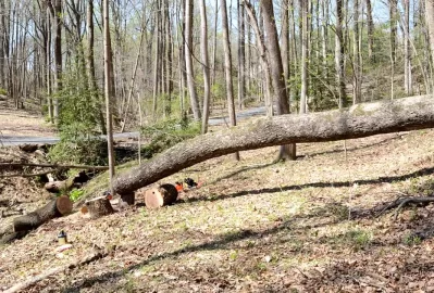

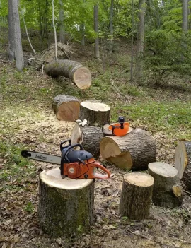

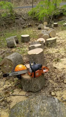

Finally got around to bucking this tree. I started a couple of weeks ago but it was too warm so I waited for a cool day. First big project for my Dolmar PS-7910! I started at the creek and and worked my way over toward the base. I thought the trunk was resting on the creek bank but I wedged a round underneath to give it a bit more support. Turns out I had a bit of an issue because there was some lateral stress on the tree, so when I tried making the first cut I got the bar pinched as the trunk moved sideways. After a bit of wedge and hammer work I managed to cut the trunk free, but that warmed me up pretty well so I declared a minor victory and called it a day.
Today I finished the job in pretty short order. The first few rounds had to be undercut but before long the tree was hanging in mid-air and I was able to just slice away. It was a little awkward at times because parts of the trunk were still chest-high. All I have for the Dolmar is a 20" bar but I found myself wishing for at least a 24-incher because the trunk was bigger than I had estimated--about 23" X 26" at the base. It also seemed like some of the toughest wood I've cut, maybe because it was a leaner and grew pretty dense to compensate. This also means that the rounds are too heavy to move very far so I think I'll have to split in place. I can hardly wait to start! :eek:!!!<>
The first pic below shows where I stopped a couple of weeks ago after cutting the top part free. #2 was at about the halfway mark today, with the tree floating in mid-air. The last two are victory pics taken after a couple of hours and a half gallon of gas...

I've never had a tree that was parallel to the ground "stand back up". I've had them float and bounce up and down.

Not to resurrect an old thread but I wanted to give you credit for calling this one--I noticed recently that after 4+ months the root ball hasn't come an inch closer to "standing back up." The trunk also floated while I was cutting it, which made life much easier. Good call! ==c
