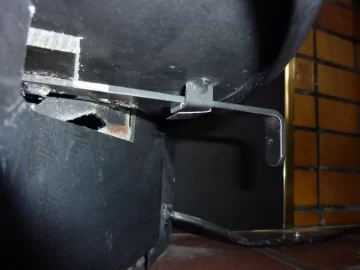

Nice that you could chime in with first-hand experience of the 80. My guess is that the right control is the air wash, and the left control may go to a channel across the top of the firebox further back, like what the 91 has (I think the right slider on the 91 feeds both the air wash and the channel.) Unless the left and right controls on the 80 do different things, two wouldn't be necessary. I just happened to be working on the 91 yesterday....and accidentally got a pic of rear air channel across the top of the box:
