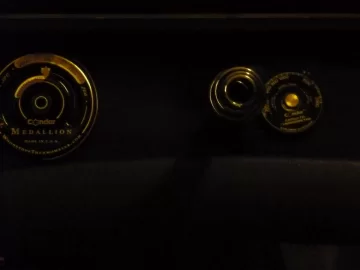

What do you think is getting too hot, the stove, the liner or the cat? Have you got a stove meter? I have one on the front of the stove next to the bypass rod, about where I think the top of the fire box intersects the front of the stove. I estimate that if I could get a meter flat on the stove top, it might read maybe a couple hundred degrees hotter than the readings I'm getting on the front of the stove. I have seen up to 550 on the front of the stove in the past when it was running hot but now that I have better control of the air, it might hit 500, max. I don't have a flue meter but I can tell when the liner is getting hot (when I have too much flame in the box at startup) because I will hear the liner expanding at the flue collar, making a sharp popping sound, distinct from the normal "stove heating up" sounds.

If you load your stove on a large red coal bed its going to take off. Cat stoves are made for its long burn time cycle from full load to almost ashes.Thats the reason you hear people talk about these 8+ hours and some alot more burn time. These type of of wood stoves works on a complete burn cycle.
Right. I was loading at 12-hr. intervals, but sometimes it was sooner. I generally would pull some coals up front and burn a few small splits to get the cat meter up around 900 or so. I didn't want to have coals under all the wood or I would end up with too much wood gassing at once, so I would pull the coals to the center, front to back. Then I'd load most of the wood on the sides with no coals under it. Onto the row of coals in the center I would put a few smaller splits, then feed the center with shotgun air to get the smaller splits going, with not a lot of air wash air at this point (air wash will tend to spread the fire into the wood on the sides more quickly.) I would then bring the cat meter back up to 900 or over, then close the bypass. I might then cut the shotgun some and open the air wash a bit to keep flame in the box until the cat took off, as evidenced by the cat temp steadily rising. Better yet is when I see the cat glowing...then I know the cat burn will sustain itself. If I tried to cut the air too early, the cat might crash and I would have smoke out of the flue. Now the 80 being a bit smaller, may come up to temp and light off the cat faster.
BTW, on the 91 I can see the cat glowing by looking in around the bypass rod hole, but it's not easy to see. I have to move my head around to get the right angle to where I can see the cat glow, through that small opening. If the cat is really glowing brightly I can see the glow through the air wash, reflecting off the top of the cat shield. Maybe @coltfever can tell us if it's possible to see the cat glow through the bypass rod hole in the 80.
yea you can see the glowing thru the rod opening in the early light off and also its reflection on top of heat shield at times.
