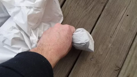

How clean? Here's what came out of 32' on the last cleaning:

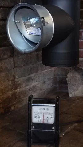

So we have a barometric damper installed in addition to the key damper. Starting from the stove we then have the draft gauge, next the key damper, and then the barometric damper.
[Hearth.com] Auto dampner
Does it make a difference? Yes, of course. With the barometric set at 0.10" w.c., the key damper fully closed, and a dying fire in the firebox we have 0.08" w.c. of draft, which is the lowest I've seen the draft without the stove door open.

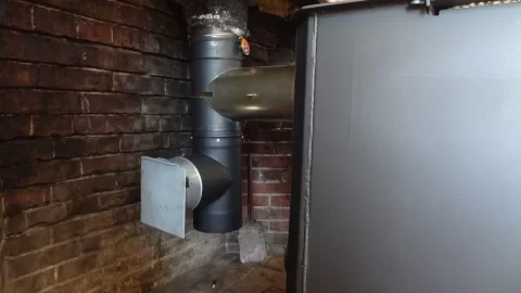

Here's the safety lid installed. Still some airflow at the hinge, but nothing like the full 6"
The point of the exercise is to see if the difference between 0.08" and 0.15" w.c. results in enough fuel savings in milder weather to merit seeking additional draft mitigation measures beyond the fully-closed key damper.
