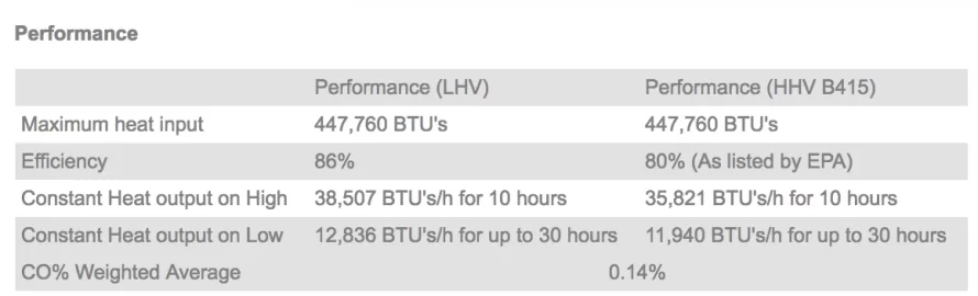

There are countless (often hostile) threads on this forum, about BK vs. Woodstock burn times, most often BK King vs. Woodstock Progress Hybrid or Ideal Steel. That little search window at the top right corner of this page will turn them up. The Woodstock hybrids get very good burn times, but the BK's often go another 30% beyond that, normalized for firebox size. That translates to a wider range of available output, for the same size stove.
![[Hearth.com] Advice on new stove [Hearth.com] Advice on new stove](https://www.hearth.com/talk/data/attachments/198/198878-a2ebe3f59a5f77a96e20f4f8e437e32d.jpg?hash=wyM-5cMWDl)
