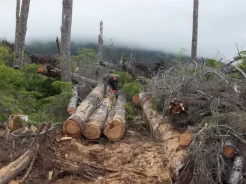

562 xp with a 28 inch bar had no problem with these logs !
