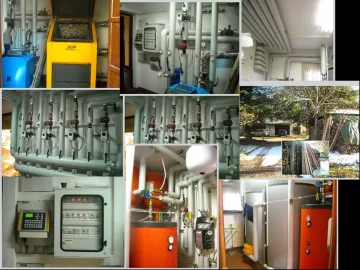

I am a newbie to the forum and live in the greater Boston area. I am familiar with wood burning furnaces as growing up in Europe i got to see more than one. For instance my uncle has a Kob(see picture below) ECO 65 (Austrian made) with lambda oxygen sensor control and separate 1100 gal of storage tanks to heat up his large house and indoor pool. The think works like a champ.

Anyhow, I appreciate comments and info. BTW, how much does a cord of apple tree wood or leaf wood weigh on average when green?. The attached picture is the picture i wanted to attach yesterday in my first post and didn't work right.
