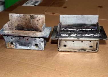

Sure! But as I've alluded to my work is not pro by any means, I'm a self taught welder (aside from our required HS shop class) with a $80 harbor freight special lol. So I post these pics not to impress but more so as proof I did it I guess you could say.

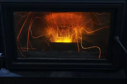

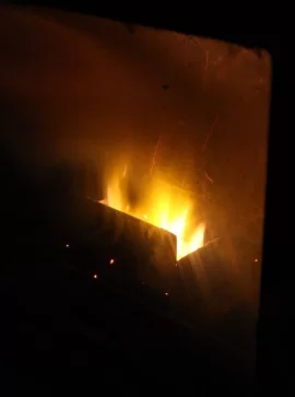

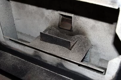

I finished it up this morning, cleaned it up for a quick photo shoot and then fired the stove up. Been running now for 30+ minutes so far so good. I was in a hurry to get it running so I skipped cleaning the door so no pics of it in operation yet
![shuteye <> <>](/talk/styles/default/xenforo/smileys/shuteye.gif)
but maybe I'll shut it down this evening to inspect, and clean the stove up. This side of the house has been in the 50's lately so it's nice to get some heat back in here. My house layout just isn't good for heating from a single stove where my wood stove currently is.

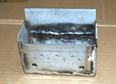

View attachment 176076 View attachment 176075

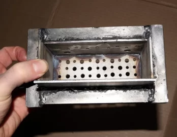

I test fit the main body before welding on the flange pieces. Unfortunately I made it just a smidgen to wide front-to-back and it wouldn't seat properly. But my welds were pretty globy so I ground down the front and back so all the welds were flush. That allowed it to fit in tightly, but it did fit. If I were to do it again I'd pay more attention to the front-to-back dimensions. There is plenty of wiggle room side-side.

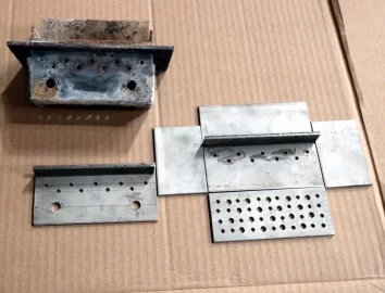

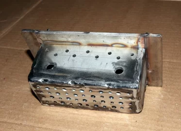

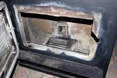

View attachment 176080 View attachment 176079 View attachment 176078
Pot is done. I used the same thickness for the flange all the way around so I didn't have to get another size of flat bar. The factory one was wider on the edges, but I didn't see the harm in making it all the wider piece all the way around. I'll pay attention to the ash pile and see how well this is sealing. If not, I'll just put some scrap flat gasket underneath.
