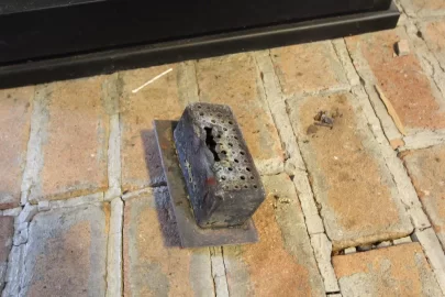

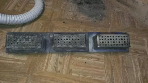

Here is mine a few days ago when this thread started.
*picture removed*

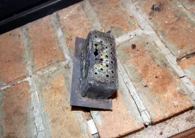

And its degraded fast... a few other chunks apparently came apart between the first pic and when I shut it down yesterday to clean...
*picture removed*
I have to admit though that up to this point the problems I've been dealing with have been less than optimal burns from time to time. Not sure how much that effected the demise of the pot, but its pretty obvious they can't stand up to too much of a beating. And one by one I've been trying to fix or implement whatever suggestions folks have had here.
Yeah and I don't mean to deviate from your thread... but I wonder if the pot in that condition is causing some of my current issues. I've noticed after I lined my chimney with 4" duravent that the pot stays clean. I switched to only cleaning it out every other day and the pot is clean each time with minimal build up. Before, once the burn started to degrade the pot would clog up with junk. Now my pot is staying clean, even yesterday, but I'm still getting soot on the glass and some smoke out the chimney. But I won't draw any conclusions until I have a proper burn pot installed. I sent in a warranty request. I'd shut down the stove entirely if it wasn't for the fact that it still seems to be throwing out plenty of heat and is desperately needed tonight as its suppose to get down around -10F with wind chills pushing it down to around -20. That's about the coldest it ever gets around here.

Wow, that's a wrecked pot. As soon as mine took a turn in that direction I was asking for new ones, but I guess I can see where continuing to use it would have probably got mine there as well. That just looks like the metal failing to me, which supports my conclusions.

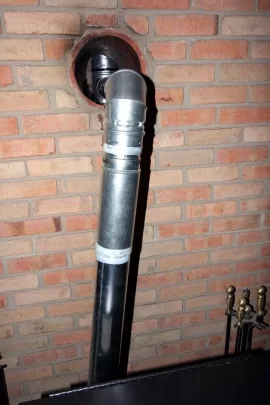

so yes I am very familiar with the entire manual including that little line. My flue is 6" round which I lined myself a few years ago for my Hearthstone Shelburne. What I did about 2 weeks ago was reluctantly pull the liner out and put 4" duravent up the old chimney (about 15' tall).
<Here is what it looks like now with duravent all the way, before packing the thimble with Roxul. Still have to finish it off with something to cover the thimble that looks nice though.![[Hearth.com] 25-PAH Premature Burn Pot Failure - My fault or the burn pots? (2 burn pots in 4 months) [Hearth.com] 25-PAH Premature Burn Pot Failure - My fault or the burn pots? (2 burn pots in 4 months)](https://www.hearth.com/talk/data/attachments/154/154171-bf2b8d3ac32babd351df0855afaad40c.jpg?hash=XK8LzjuF1c)

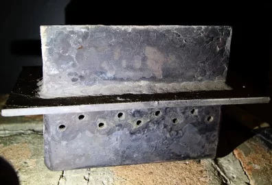

I would suspect a flaw in the metal of your pots - perhaps over heating by an inexperienced welder? I seen that degradation in miscellanous items that were "over-heated" by poor welding skills. If it was my stove I would plasma out the bottom and re-weld a new floor in it.... but then again you need welding skills too..

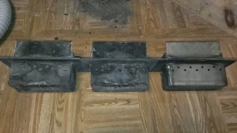

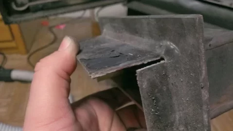

Where having the same problem with our ashley 5660l burn pots. The problem is cheap chinese crap metal. ( yes my stove is spotless all nooks and crannies, chimney pipe, combustion motor removed all flue passages clean, before somebody starts that conversation) its not your fault. My burn pot is actually getting built today as we speak at a machine shop with better materials. Thats the only solution in my eyes.
I'm pursuing a similar route - having a better burn pot built.
Ill keep posted. The shop is trying to go thicker with metal not from the east end of the worldWould be interested in knowing the details of your builds. Type of steel, costs, etc. Of course how well it performs as you use it also.
