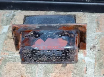

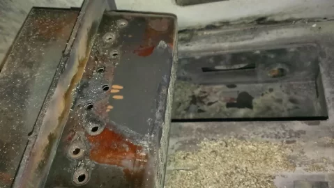

I have to agree. Take a look at these pictures of my new burn-pot after just 48hrs of running (at full power, with the factory (lean) settings). You can see on the bottom of the pot metal is already flaking off, as well as some real big chunks on the back side. It's interesting to note that the worst of the degradation seems to happen not inside the pot, where the fire is, but on the outside/bottom.
@stoveguy2esw - is this normal? Why are these burn pots coming apart like this?
[Hearth.com] 25-PAH Premature Burn Pot Failure - My fault or the burn pots? (2 burn pots in 4  months) [Hearth.com] 25-PAH Premature Burn Pot Failure - My fault or the burn pots? (2 burn pots in 4  months)
That scorching (per se) of the metal looks like what happens when I heat up a frozen nut with acetylene torch... it flakes and cracks and the o2 blows off pieces of the metal, the next phase is cutting through the fastener. In my opinion, either you have a significantly gas rich air supply or those pots are junk, (or both I guess). If that is a brand new pot I would be getting in touch with ESW to replace it under warranty and have them figure out what is happening. $68 pots are going to get expensive for you quickly.

I'm not one to toot my own horn but I am in the steel business in my real life..... The ideal steel to use is fire resistant, boiler plate steel. Fire resistant steel refers to the steel's ability to resist heat induced oxidation, which, is what is occuring in this case. I bet those pots are A36 low carbon sheet or cheap azzed steel. Fine to make the stove cabinet from, not so good for a firepot.

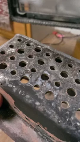

My new one looks about the same after just a few days...

Burning Somersets which is a very common and sought after pellet. I ran it near high (up to 8 for around a day) but the rest of the time has been in the 4-7 range mostly. Air and fuel trim on factory default and seem to be good best I can tell.
I guess I shouldn't be so concerned that I get some discoloration of the stainless pot in my CPM. Something is not right with the way that metal is decomposing.
Looks to be cheap azzed steel (possibly Chinese)...lol
I can make stainless do that too. At least 3 series.

My new pot (from the previous thread) has been running about 6 weeks and it is starting to show some of the same signs. Bits of metal flaking off. It hasn't gotten anywhere near what my other one was, but I doubt it will last the 3 years they're saying should be the useful life.
