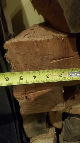

I split my own wood.. For overnight I split that wood square and rectangle.. This allows me to pack the box completely full.. My box is 2.3 cuft the Dauntless is a 1.8cuft.. Using oak and hickory Iv gotten 16 hours.
You guys with the smaller box should be able to push to 10 with a quality hardwood split correctly.. the quality of what your putting into the box is what your going to get out in heat output and Length of burn..
I have an encore. Because I had to buy some of this wood I haven't split it all myself. Usually I get 8-9 hours packing the box. I just tetris it together until it's full to the griddle.
Here is a pic of the wood I use for overnight
