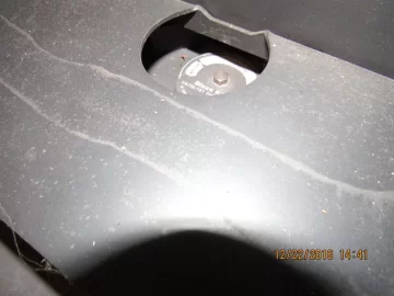

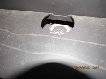

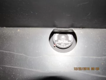

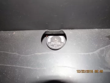

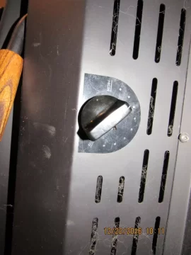

I did notice that your cat term may need adjustment. My needle sits at the bottom of the inactive zone, not below. Others can confirm.

hey shoot-straight. thats interesting that you mention the fans... shortly after posting i turned the fans completely off to be sure I had a good coal bed to reload on and nearly 2 hours later, the sensor is showing that cat back in active! I didnt do anything except turn the fans off. The stove top temp is only about 250, but I definitely agree the fans seems to shorten my cycle. That said, if I dont have them on, I dont think I get enough heat...
also, my cat therm does go lower than my first pic, I guess because the stove was still a little hot from the previous burn. when its completely cold the arrow points as low as possible.

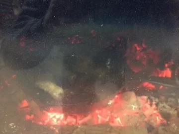

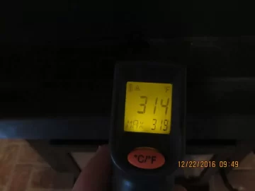

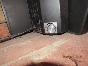

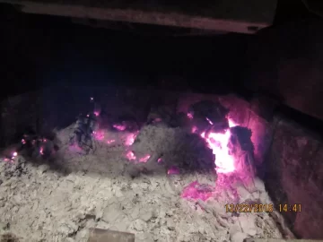

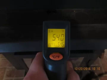

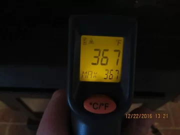

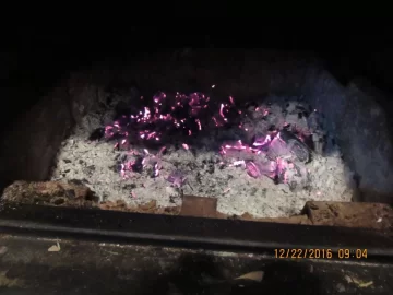

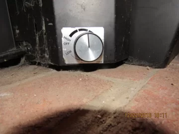

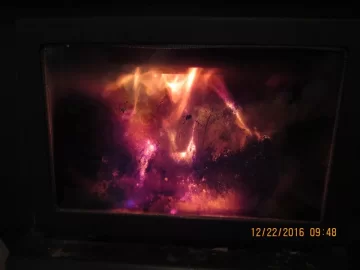

Hey all. I wanted to document the performance of my BK Princess Insert and get some feedback if this is looking like typical performance or maybe if I could be doing something better.
Here's a morning/afternoon on a warmer than usual December day in New Jersey. My wood is seasoned and under 14%. My upstairs 1970's Earth Stove puts out a ton of heat with this wood so I dont believe my issues are wood related.
Here's a typical burn cycle which lasted about 5.5 hours.
9:03 AM (after reloading 10:30PM the prior night) 33 degrees outside, 61 degrees inside.
View attachment 191051 View attachment 191052
Full reload:
9:48AM - cat goes ACTIVE, bypass is thrown and t-stat remains on HIGH
10:10AM - stove is 500 degrees+ and I lower the t-stat and put on fans. Room is 63 degrees, up 2 degrees in an hour
10:39 - stove is still getting hotter. 64 degrees inside. 37 outside
11:07 - 68 inside. Stove is still way active, but lower than before.
1:21 PM - back from errands. Almost inactive
2:41 PM - inactive cat. Room is 70 and comfortable, but also a warmer than usual 44 degrees outside.I'd start thinking about reload around here.
