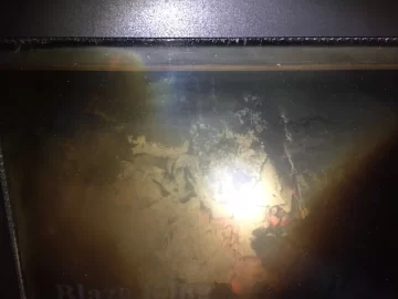

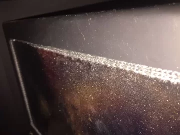

Is this window gasket cause for concern? It seems to be coming out a bit on one side.
Does the glass move up and down? Is the gasket old or new? Looks to me that it was installed wrong or the glass is real loose and the gasket has moved on you.
The nuts to tighten the glass retaining clips are under the thicker door gasket. You should be able to look through the glass and see whether the gasket is or is not pinched around the glass. My glass gasket certainly doesn't hang out that far and if it did I would be worried that it had fallen out.
The glass retaining clips on mine were not installed properly, a huge chunk of weld/chrome slag was trapped under the clip and once it was removed I could get a lot more turning on that glass clip retaining nut.
The thing to worry about is air leaks. We know how important a tight door gasket is, well a glass gasket leak is just as devastating.
To replace the glass gasket, you must remove the door gasket too.
Reactions: Ashful
Damn, ok, thanks, guess it gives me a good excuse to change the door gasket.

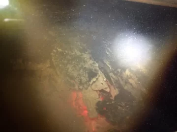

30s last night and near 40 today so 24hr burn territory. Set on 1.5(yes I have the good label) about 10 hours in.
[Hearth.com] 2016-17 Blaze King Performance Thread (Everything BK) Part 2
Stove darn near still full, hard to get a good pic though.

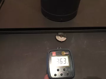

About 22 1/2 hours in.
