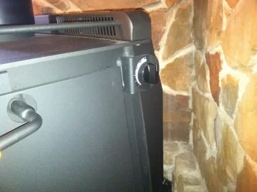

View attachment 163910 View attachment 163909 I relocated my sticker to the front side of the knob and reset the knob position 180 degrees. I also added numbers. Now I can see what I'm setting it at. Before it was difficult because I have a corner install. Also now when you " turn it up" for more heat you are actually turning it up
That's awesome! My stove is in an alcove so that would help.
How easy was it to reset the knob position? How did you get the label off, a hair dryer? How long did it take?

turn the tsat to max setting, loosen set screw so you can remove the knob. sticker will just peel off, no need for hair dryer. reposition the sticker then reinstall knob and tighten so it matches the max position on sticker. I did get a spare sticker from blaze king, but the old one comes right off and you can reuse it. takes 2 minutes to do
it's a 5/64 allen wrench. I reused the old sticker originally, and it works fine that way. I got a replacement sticker so I could comfortably put the numbers on at the kitchen table then just pulled the knob off again and installed the new sticker.

I just don't understand why they would have the sticker on the backside of the knob when it's hard enough to see to begin with. this makes it a lot easier for us corner/alcove users.
That is a good idea. I have an alcove install and it would have been useful for me in the first year. At this point I don't even look at the knob while turning it; I just reach back and set it by feel.
I have a lot of different people who tend to the stove on different days. With it this way I can just tell them to turn it up to 4 if your cold etc. they could see the line on the knob and the numbers. And it's natural to turn something "up" to make it hotter and down for colder

Great idea. Now I see what you meant by "in front". I would make this mod but don't want to risk damaging my now irreplaceable BK numbered sticker. The only problem I can see is that it is uncomfortable to turn the knob back to the midpoint. My thumb doesn't bend back like that.
It's no different than how you have it now. Close your eyes and turn the knob each direction- no difference. It's just the sticker your moving. you still grasp the knob as you normally would to turn it down or up
By the way, the swoosh is the perfect sticker to do this mod! All hail the swoosh :)
Because after you get through your first January with the stove you won't be using the numbers anymore and for the rest of the life of the stove it is likely more aesthetically pleasing to have them out of sight behind the knob. I guess.
Well heck, just have open, halfway and closed then if the Tstat setting is so meaningless :rolleyes:
