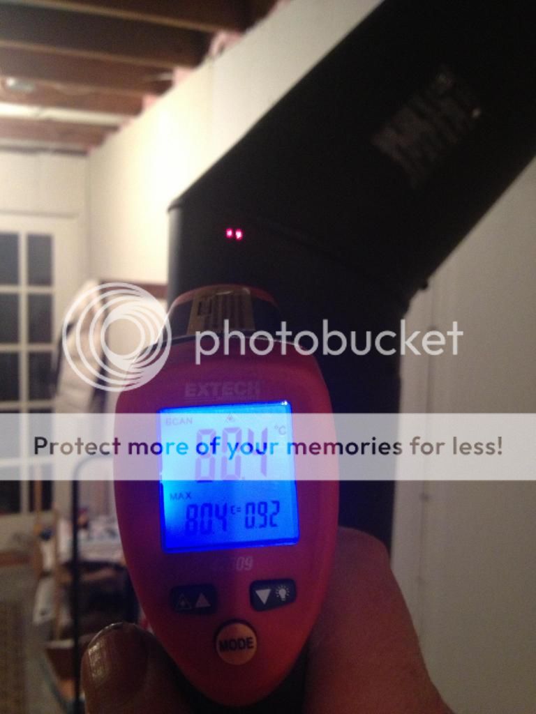

So anyhow, she's been on for a few hours. Set @ 1.5
[Hearth.com] 2014-2015 Blaze King Performance thread (Everything BK)
Stove pipe temps. DWP. 80C
About 300C ontop.

The outer temps of double wall pipe are absolutely not half of the internal temps. That is for single wall pipe. The only way to measure internal temps on a double wall pipe is with a probe meter. I have one from condar and I recommend them to anyone with double wall.
