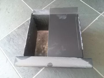

Can any Ultra or Sirocco owners post a closeup of their ashpans in the pedestals? I'm looking hard at replacing my Napoleon 1450 with either a Sirocco 30 or maybe upping to a King Ultra and through the pages of threads I've gone through so far, I can't for the life of me found any pics of the ashpans.
Thanks!
Thanks!
I like the ash pan a lot, but not the plug. If I even shovel too many ashes out and disturb the plug, I have a bit of an air leak for a while. Otherwise, it is fine. I like the hinged cover.
I have removed the plug and used the ash pan once. It holds a lot more than it looks like it can.

About the ashpan, I have it and have never used it in a year and a half if burning. I think it's much easier just shovelling out in a ash can. Also I think it just another thing that could go wrong. Maybe an air leak or something.
Awesome pics, thanks!
Does the pan just fit in loosely into the pedestal or is it on some type of sliders?
