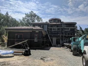

Thanks ! @begreen below is current stage if house. We are doing awesome Andersen windows and barrel tile roof (being finished now) and insulation is great. The fireplace is location between the kitchen and the great room on the middle of a long wall. We are about 6 months from completion so hoping for a nice cozy winter in there.
