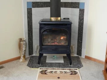

Most of those here with pellet stoves don't have access to NG or we would throw these beasts out the back door. If you like the look of a wood fire, get a 50" flat screen and run a looped video of a fire on it. :)
I have a very nice Propain heater and if the price of gas was cheaper I would be using it exclusively. As it is its used as backup and for ambiance.

Ha ha ha...I'm headed out to look around tomorrow.... Should I be concerned with the square footage(600feet) of the room I'm looking to heat?
Any particular recommendations on a Gas stove?
