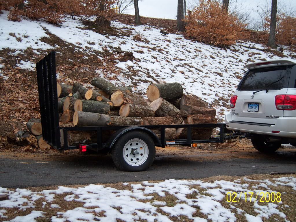

and buy the way i used to burn over 2000 gallons of oil in a 5000 sf home this year i have burned 250 keeping the bed rooms warm at night so with the price of oil at 3.25 a gallon ill about have the northstar paid for this year. now i will burn about six cord this year i would normally say that was a cost but i got it all free and should be able to have next year set by the end of feb. a truck,trailer,good chainsaw and a neighbor with a splitter really helps
big stuff is oak. and there is five more trailer loads where that came from
