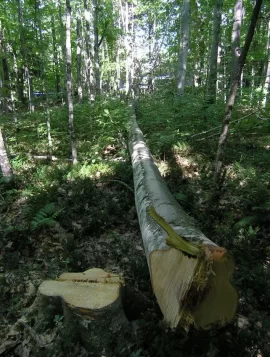

First, need to cut some trees down:
[Hearth.com] YAWS (Yet another woodshed), from scratch
This tree was dead, but the trunk was in perfectly good shape. Same with another I felled. Many others are not in such good shape.

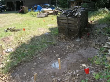

The footings are in place:
Beech will rot quickly in contact with the ground, so I used the same concrete footings as for the previous shed. Note there is a woodpile right in the middle; there was a second one closer to the camera that I unstacked in a pile off camera. I couldn't bear to do that again, so I built around this stack. Note also the multiple layers of shredded tarp on the pile in the background. This is why I need sheds, tarps cannot survive UP weather.
