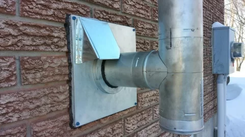

That makes sense, so frigid Canadian air coming in the OAK and possibly freeze the flapper! My OAK is short on the XXV compared to the P61A, so it's entirely possible. I think I will fabricate a hood for the entry point outside, preventing the wind from entering the pipe while the stove is idle.
Grabbing straws here but if you think this is the issue my suggestion is to add a couple of feet to the flex line so it warms a little prior to entering the stove.

All went well, time will tell I guess. Keeping an eye on the exhaust blower. I put a hood on the intake port hole outside. Here is the video.
All went well, time will tell I guess. Keeping an eye on the exhaust blower. I put a hood on the intake port hole outside. Was going to post a short video but wont accept mpeg or wmv.

Yes it's running fine, also much nicer with the draft set to -.45. I can only assume the frozen fresh air flapper, the possibility of the exhaust motor is hard to imagine as I left it on test for an hour and the meter readings were consistent. Some messed up logic on the board? is that possible?

While the OP is still here and for future reference what does the wind load look like on that stove's vent side?

The wind did come from that direction for a few days, North/East. I bought a metal hood to put on top so the cold air is not allowed to blow straight in.
