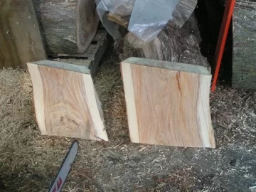

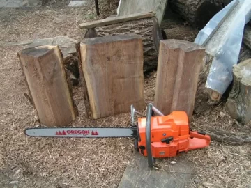

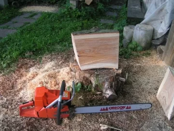

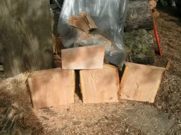

I rough mill them to random sizes freehand with chainsaw longer pieces over 3 feet I set up the Alaskan mill,finish them up on Delta heavy duty bandsaw w/ riser block & 1 1/2HP motor.Can handle 12 1/2" thick material if I dont force it.Ends are squared up,coated with Anchorseal & stored inside out of the sunlight for a few months.Keep some for future use,sell remainder as green turning/carving blocks on Ebay/Craigslist.
