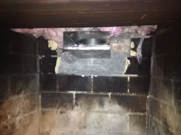

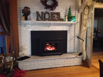

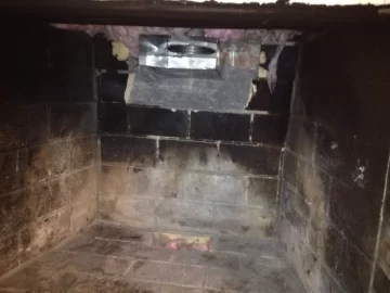

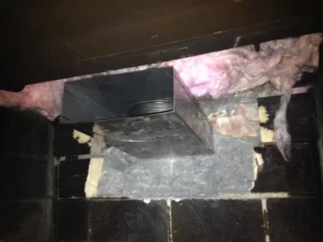

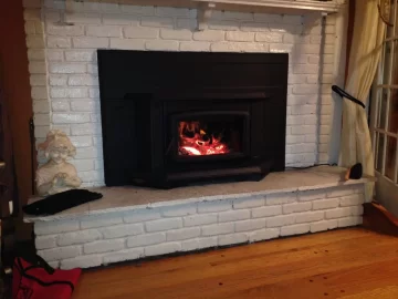

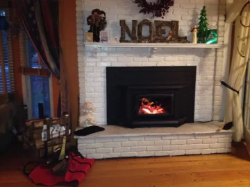

The Hearthstone Clydesdale actually comes from the factory with the outlet set at the 45 degree angle out the back. You have to turn it around to have it go straight up. This should be a relatively easy insert to get to fit in your space but there is not going to be much room to work in a 26 inch tall space. The Clydesdale is 23 inches tall. I installed mine last weekend.
Here are some Pics:
[Hearth.com] Wood stove insert for my hearth conditions? [Hearth.com] Wood stove insert for my hearth conditions? [Hearth.com] Wood stove insert for my hearth conditions?
Looks very nice. You might consider swapping the pink fibreglass around the flue for some rock wool. Fibreglass and heat didn't go well together for me. Stinks when it gets hot.
Thanks, that's why I posted those pics to get any input. We will see how it goes.
