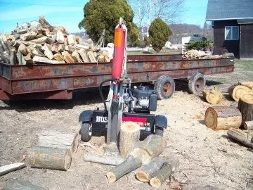

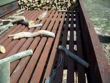

Here is the way I store and dry some of my wood. It is a mobile home trailer frame cut down to 25ft long with the frame doubled up for the sides. I welded in slats in the bottem so it gets air flow and stays dry. I load it up and then take it out back in a sunny, windy spot and when I'm ready for it I haul it back to my shed and unload and stack it inside. It holds about 4 cord. I've got about $150 in it.

That's sweet; the rolling heapenhausen.
Looks like a good plan..
This wood is for 2012. I've got 2011 stacked and some in crates. I've been working on getting ahead as my gasifier needs dry wood.
leaddog
nice idea and sure saves some stacking and moving . Maybe you could find one or two more and make a train :)
Pretty sweet idea....what do you haul that monster rolling heap hausen with?
Must be upwards of 15k lbs when loaded.

I have a 4x4 Century 40hp tractor and loaded it does take some power if I have to go up hill. I also have an other trailer simular that holds about 1 1/2 cord that we load and haul to my sons. I like these as I can just throw the wood on from the splitter and let it dry with out haveing to stack. It's a pain welding in all the slats for the bottem but I've got lots of time so it works well for me.
