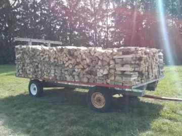

I stack directly off the splitter, and then load it into my wagon right from the stack, to haul it up to the house when I use it:

I do use a mini hay wagon for moving the wood already, but I think it would be a poor choice for storing wood for drying. That’s a lot of tires and running gear to maintain, per cord of wood stored, and a lot of weight sitting on four patches of dirt for three years of weathering. They’re also not cheap!
I was thinking just for wood that will be used that season. You're right about lots of them for 3 years or more seasoned. How much do you fit on 1 load pictured?
Almost exactly 1 cord. It’s 4’ x 8’ footprint, and mounded to about 4.5’ in the middle, tapering to 3.5’ at the ends. This lasts me about 3 weeks, on my normal burning schedule, and I use about 9-10 per year.
