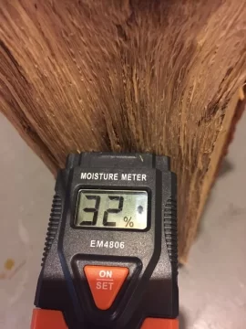

UPDATE: January 22, 2016. Today I brought a piece of red oak inside and warmed it up. It has been c/s/s for 10 months now (1 spring/summer/fall) and split a piece and the MM read 32%, down 13% since September. Making progress, back into the stack it goes.
