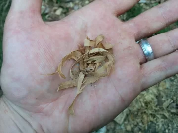

Get the bar buried in pine, fir or some other soft woods and skip will cut faster than full comp. It has a lot to do with clearing the chips. You can plug the gap with full whereas skip takes a bit more.
Good point. The thing is, there are a lot of variables in play that determine how easy and efficient the cutting is, and the effect of any change you might make depends on the larger context -- wood species and condition, available horsepower, bar length, chain pitch, tooth shape and pattern, the number of teeth on the sprocket, etc. It's easy enough to suggest solutions if you have a specific problem you want to solve, e.g. if you want to cut faster, or smoother, or stay sharp longer, or to be able to lean on the saw in the cut without stalling it so easily, but there are always trade-offs, and no one set of hardware is best for all conditions.
So, OP, if you could change one thing about the way your saw has been behaving, what would it be?
![[Hearth.com] Will need a new chain soon. Time to increase my chain IQ. [Hearth.com] Will need a new chain soon. Time to increase my chain IQ.](https://www.hearth.com/talk/data/attachments/141/141839-46fba9fce00d42acff6203c448556ec8.jpg?hash=QCOBrD9kLN)
