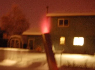

The pocket rocket will work, very well, the first time. Here is the exhaust cone on mine.

I am not finding the exact .pdf I built from this morning, but any of these should work well.
https://canadiandirtbags.wordpress.com/2010/12/05/how-to-build-a-pocket-rocket/
http://homesteadlaboratory.blogspot.com/2014/01/pocket-rocket-stove.html
http://www.rocketstoves.com/pdf/pocketrocket.pdf
If the neighbors aren't pulling back the curtains to see the jet airplane crashing into your back yard, well, you don't have enough draft and it isn't really a rocket stove yet.
