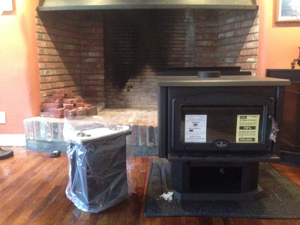

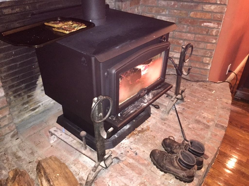

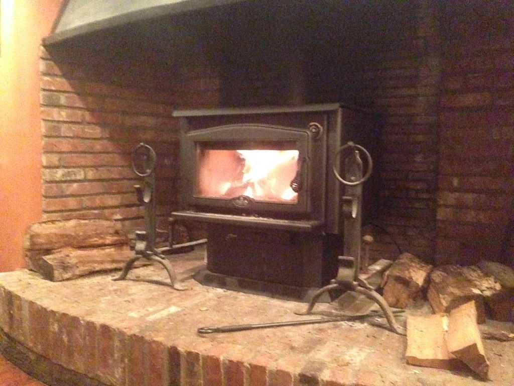

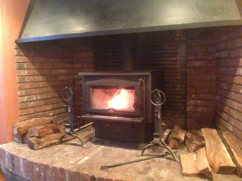

The Osburn 2400 arrived mid Feb, removed firebricks and wheeled it in with the help of a friend and hand-truck. Laid bricks in the fireplace hearth to level it out, and set it in place. It looks great, everyone has commented about how well it fits in the opening as well as matches the black hood.
This stove tends to burn hotter than my Napoleon 1401, damper is usually on lower to mid setting... easily warms the whole downstairs. Sweeping the ashes down the hole into the ash drawer is so convenient.
I have yet to cut some metal to fit on either side of the liner where it passes through the damper opening. Top of chimney has a 18x18 hat over the clay flue.
Thanks for all the help, very happy with this stove!
