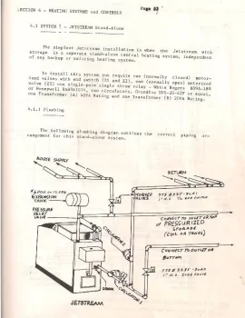

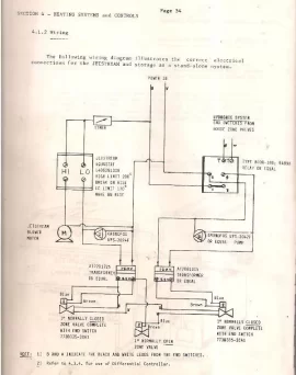

I don't know if these diagrams will help or not. These drawings are 30 yrs. old.
Allan
