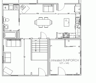

RE: the Summit. That's a jump up from the mid-sized PE. How is this area connected to the rest of the house? Are there large connecting openings to the other area or smaller doors? Is there a stairwell adjacent to the stove area? If yes, is the ceiling flat and continuous to the stairwell or is there a doorway break in between? If you can post some pictures and/or a sketch that would help.

The area is connected by 2 small doors on the south side of the room. Stove will be in the North/west corner. Stairwell is also on south side of room. But, the ceiling is definately not flat. The ceiling joists are currently exposed. (they run east to west)
Will this be a big restriction to air movement? My plan was to leave the celing joists about 4" proud from the surface of the sheetrock - (currently no sheetrock installed) for an exposed beam effect. I may rethink this - if it will cause air movement to "stall" in the dining room.
Great diagram. Stick with the Super 27. It looks like you will get good heating on the first floor and some benefit on the second. Don't worry about the exposed ceiling joists. I was asking about something more like a door or archway significantly below the ceiling. You should be fine.
OK thanks, I was getting worried about the exposed joists...
Diagram is via an OLD version of Home Architect, very simple to use and CHEAP ;) ($6 on auction site)
