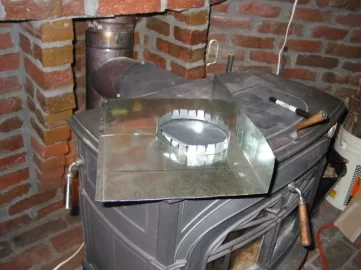

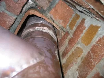

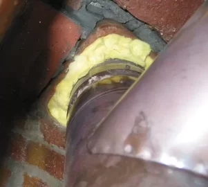

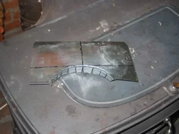

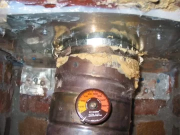

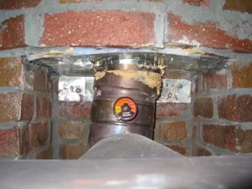

Bringing this back up, I finally dumped the camera onto the computer, and have some photos of the bottom block-off plate that I made... I have also been having some white knuckled adventures up at the top of the chimney - will also post some more about that...
The first shot is looking up the bottom of the stack past the tee on the back of the stove to where the SS liner goes into the clay flue liner... The tile edges are not completely flush with the bricks, but are pretty close. The masonry and bricks aren't all that even either.

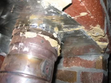

The second shot is from the other side of the stove, and shows how I stuffed the gap between the tile and liner full of fiberglass pipe insulation - note the yellow stuff...
After stuffing, I cut this first piece of sheet metal out of a section of 26g metal duct that I got at the local hardware store - the square metal section on the back is a "factory bend" and will go up against the back wall of the chimney area. The hole was cut to fit around the SS liner, with the flaps to allow clamping it around the pipe. The split in the center will be covered by a second piece
Once I got it cut, I had to test fit it, this is one of the later test fits, just before I did the final install.
After I got it to fit, I applied LOTS of refractory cement and silicone, and got it up in place.

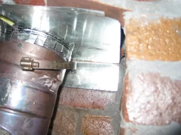

Then I cut the second piece to go around the front of the pipe and seal the slit in the first piece.
Finally I got it all in with a couple shots of the finished installation. It looks rather sloppy, in terms of the silicone and cement drippings, but it doesn't really show unless one is really crawling around near the stove and looking up. You can't see any of it from above, and even looking in it's mostly shadowed pretty heavily.

The bottom block off plate seems to have helped a little bit, but not very much...

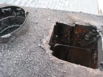

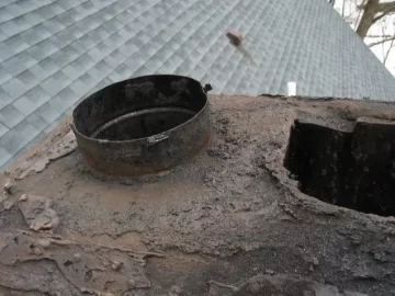

One of the other things I wanted to do is to pour the space in between the stainless steel liner and the flue tiles full of vermiculite so as to insulate the stack, especially the part of the chimney above the roofline, and thus reduce the amount of creosote condensing there.
I also got a couple of Proper-topper "Extendaflue" caps from Craig, so that I can get the two flues in the chimney to exit at different levels (currently they both exit at the same level) and thus hopefully make sure that I don't get any drafting from the living room flue going down the flue to the basement stove, as seems to happen on occasion now...
After gathering the materials, I spent a fair bit of time chasing a friend who is a painter, and also does chimneys on the side, hoping he could do this... I finally got him up there yesterday, and he got the existing double cap off (with much difficulty) but was not able to go further - He left the ladder up for me, and I went up there this morning and did some white-knuckle cleaning around the chimney top, and took some photos that I'll be attaching...

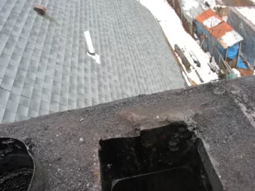

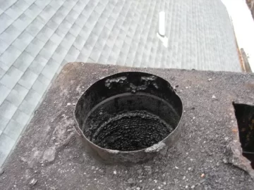

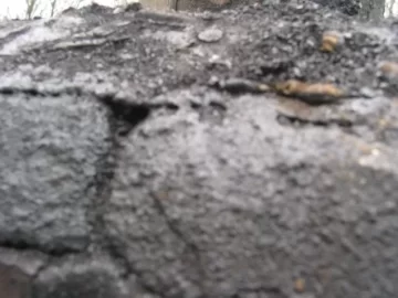

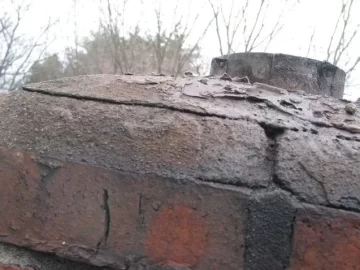

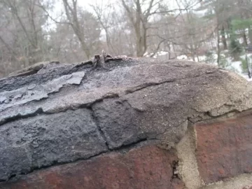

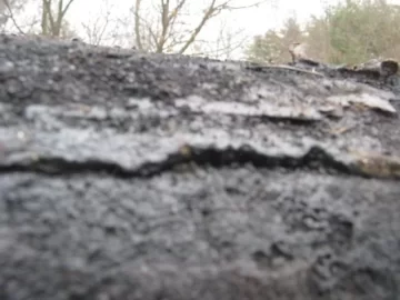

The problem is with the crown of the chimney...
As I understand the normal construction of a chimney, the clay tiles are supposed to stick up out of the crown an inch or two, and the plate that closes off the top of the flue with a liner should be removable (although perhaps not easily...) If this is the case, my approach would have been fairly easy - pull the top cover off the liner, pour in the vermiculite, put the cap back on, and then put the extendaflues on and clamp them to the exposed clay tiles as they are designed to do...
The crown on my chimney appears to have been made in two layers. Presumably the bottom layer would look like the standard construction, but then a second layer appears to have been added that covers the top plate of the liner, and the exposed tile on the basement flue... The guy that I had go up there said he was neither qualified nor comfortable with the idea of trying to chip off the upper layer of the crown, and I have decided that doing useful work while hanging onto the top of a rickety 40 foot ladder is not something I can do either... In addition I am not sure it is at all wise to attempt doing masonry work in this weather - I want the stuff to set up, not freeze up...
Right now, I have no cap on either flue, but the crown appears to be in decent shape overall - I think I can get through the winter the way it is... After burning season is over, I will find a more qualified sweep that can do masonry repairs and have him work over the crown of the chimney to get everything done right.... (Suggestions welcome, though I have one person in mind...)
Now for the photos - Sorry they are a bit disjointed, but it was the best I could do while hanging onto the ladder with one hand, and waving the camera around with the other... Between the various shots you should see the two openings for the flues - the square opening is an 8" x 8" tile that serves the basement stove (which is almost never burned) while the round one is a 6" SS liner that connects to the stove in the living-room. The living room flue is about 25' tall, the basement flue is 30-35'. You can also see the crown, and the apparent seam between the layers, and a closeup of the seam at one point...
I am very interested in any ideas on how best to deal with this, other than the approach I suggested of getting the crown reworked...
Gooserider
