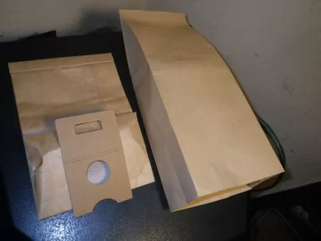

The cardboard is normally inserted into a frame on the vac-housing. This is to prevent the bag from getting pulled off the flange by the thrust of the rather powerful airsteam.
Besides the Quigg ash vac we have two "normal" vacuum cleaners in the house: An Electrolux and a Nilfisk.
The Electrolux uses the bag to the left and the Nilfisk the one to the right:
[Hearth.com] What Pellet Pellet Stove Ash Vacuum do you have and what do you like about it?
I settled on using the Nilfisk bag for several reasons:
1: The flange on the Quigg ash vac is very close to the top of the ash tank ( about one inch ), so there's not enough space for the cardboard.
2. The Nilfisk bag is long enough to rest on the bottom of the tank. As it gets full of ash, this is an important relief weightwise. The electrolux bag will just hang inside the with the risk of getting torn by the weight and air thrust.
