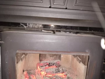

Had two smokey mornings in a row where after the fire is good and hot I start to smell and see a bit of smoke.
Both times when investigating I found burned pellet size items in a section on top of the stove. It is next to the flexible flue pipe so burning makes sense but given that there is a level of sheet metal over it not sure how stuff is getting there from above in the masonry chimney?

What I could see burning is under where pipe seems to be attached to collar on stove and below a level of sheet metal.
Picture attached in middle area on right is particulate/pellets which were burning.

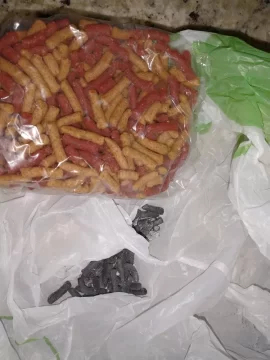

My wife pointed out it smelled like burnt food specially and the pellet stuff looks like our dog food.
I can inspect the bottom of the liner which is packed with Rockwool around it, if no gaps are there it would have to be teleporting to get through Rockwool and a layer of sheet metal. So it would have to be animals putting something there or something coming in from behind or in front of the stove where the shrouding is open to air.

To be clear here is the now fished out stuff and dog food side by side.
(See sealed packs because other than food in dogs bowl we don't allow open containers to avoid mice, but our dog is a lazy eater)
