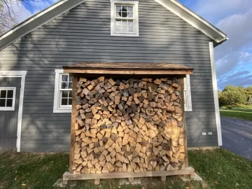

Done and done! I built a fifth very small (1 cord) shed on high ground between the barn and house. But it's up against a gable wall of the carriage barn, probably won't get good wind or rain measurements, here:
