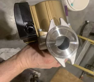

Here’s the result 2 years after a brainiac local plumber installed a hot water recirculating system for somebody using a cast iron pump and flanges, and a steel hydronic heating expansion tank instead of a potable water tank. It destroyed the above items plus really fouled up their fancy wall mount combi boiler and downstream PEX piping. Hopefully they didn’t cook or drink much of the hot water... The persistent water staining even with a softener and 2 stage filter system installed was a sign.
[Hearth.com] Water Sediment
The appropriate stainless pump that I put in:
